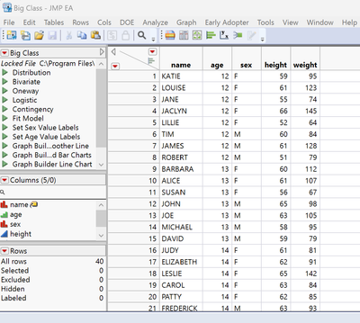

Using the Big Class sample data table, I will show how to change all of the column "sex" values of "F" to "Female"
The data table

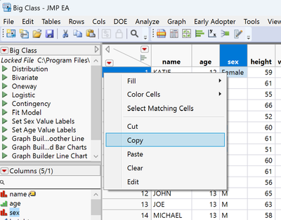

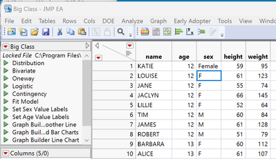

The first thing is to place the word "Female" into the paste buffer, so choose one of the cells that is to be changed, and type in "Female"
Then right click on the changed cell to select it, and select "Copy" to move it into the paste buffer

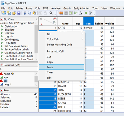

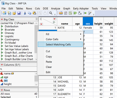

Then right click on one of the remain unchanged cells and select "Select Matching Cells"
Which selects all of the unchanged cells that you want to change and select "Paste".  The cells will all be changed at once

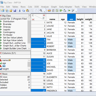

Using the same general selection method from above, Right click on one of the M cells for the Sex column and select "Select Matching Cells".  It will select all of the M cells.

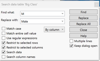

Open the Find/Replace dialog box
     Edit=>Search=>Find
Fill in the Find and the Replace value, and click on the checkboxes to restrict to only the selected columns and rows,
and then click on Replace All, and all of the cell values with M will be changed

Here is a simple example, and the way that I use this feature.
The data table
     Edit=>Search=>Find
