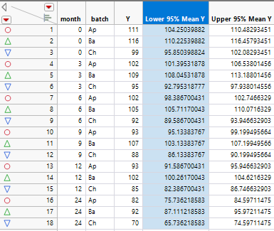

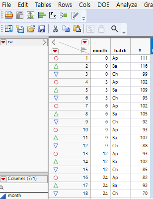

fig 1
this is data

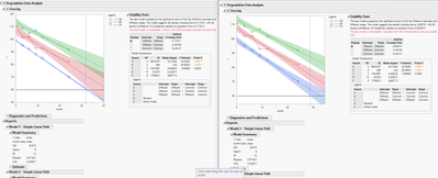

fig 2 degradation platform
left: Use Pooled MSE (Uncheck)
right: Use Pooled MSE (Check)

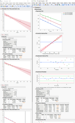

fig 3
left: fit y by x : alpha 0.1 CI is exactly same to the Pooled MSE(Uncheck)
right: fit model : Cannot draw CI figure

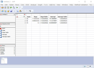

However, they always fixed to alpha=0.05, in this case I need alpha=0.1 since the original Degradation shows 0.1 CI.
So, how do I change alpha 0.05 to 0.1 in fig 3 right? (please check this at fig 4 below)

Fig 2: this is at it should be.
Fig 3: this is as it should be (the Fit Model platform does not show the confidence intervals)
1. How do I consolidate the fig3 left into one graph containing 3 lines and respective CI?? You will have save the predictions and intervals to your data table and use graph builder. That will be the same as Figure 2 left..
So, how do I change alpha 0.05 to 0.1 in fig 3 right? (please check this at fig 4 below). In the Fit Model dialog, there is a red triangle next to Model Specification. If you click on that you can "set alpha level".
