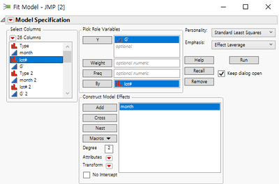

Thus, I put the Variables into the Model Fit platform as,
where G'=y and month=t.

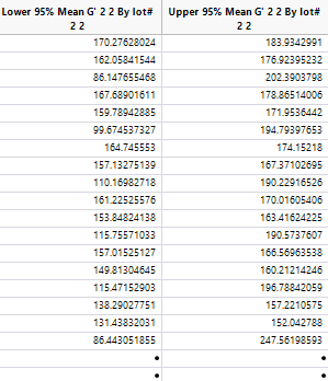

The results were reasonable until the Confidence Interval is saved in Columns.
So far above method is method A.

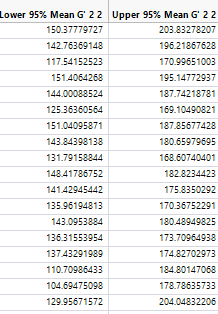

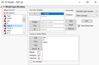

However, by different way, method B,
Inputs are as follows,
The overall results seems SAME but,
Confidence Interval is DIFFERENTLY calculated from method A.
(you can focus only to the last row, comparing the values to the previous data figure... there is huge gap.  204 <> 247)

To be honest, as I let JMP deals the DATA as "Different Slope and Different Intercept" (of course in case of both method A and B),
The Confidence interval should be look like the results of the method B.
Method A's Confidence intervals are so much alike among the batch 1,2, and 3.

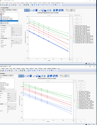

I am so happy now
I finally succeeded as following your directions.
Take a look at the result.
There are something to be fixed to be look nicer, but they accomplished the initial goals!!!
