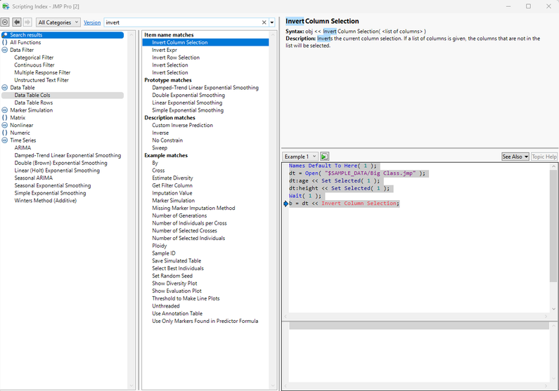

Here is the example of inverting the column selection from the Scripting Index
Names Default To Here( 1 );
dt:age << Set Selected( 1 );
dt:height << Set Selected( 1 );
Wait( 1 );
b = dt << Invert Column Selection;

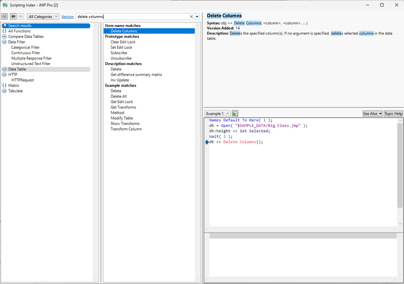

And here is the example of how to delete selected columns from the Scripting Index
dt:height << Set Selected;
Wait( 2 );
dt << Delete Columns();
