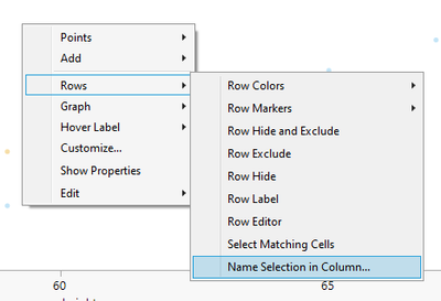

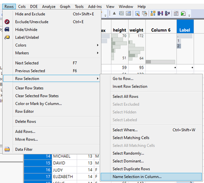

jthi
Re: Input a single value to multiple selected cells in data table at once (excel CTRL+enter equivalent)
Name Selection in Column could be enough
You can also access it from right click on graph builder
I have also made a wish list item to make it more "useful" Allow Name Selection In Column be used for multiple selections

BHarris
Level VII
This, i.e. Name selection in column, is how I used to do it, but it's frustrating that the column name doesn't default to the current column, so I often end up having to retype the column name.  There should really be a button to copy in the name of the current column, or a default so it grabs the current column name.

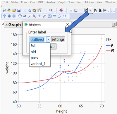

hogi
Level XIII
If you have a specific list of labels, you could also use the wand tool in the QuickSelect Toolbar.
no need to find the data table ... just select the data points/rows, click on the wand icon and select the label from list - or use your own label:
another benefit: you can specify multiple labels for one and the same row :)
existing labels in the row will not be overwritten.
Name Selection in Column: could be my favorite tool :) if ...
