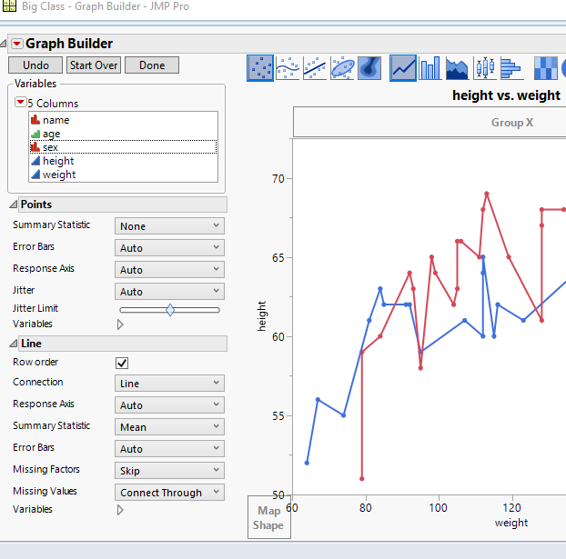

In graph builder,After plotting the "Points",how to connect points with lines?I knew use "Smoother" or "Lines" to plot lines, but the lines don't connect the points. Just like the attached picture.
txnelson
Re: how to connect points with lines in graph builder?
You can get what you want by selecting the "Row Order" check box.  Make sure your data are sorted in the row order you want the connections to be made through
Jim
13 REPLIES 13
txnelson

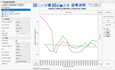

Why are my tails connecting to each other, I have it separated by instrument type and I would like the connected points to only connect for that inst:
See the green - it connects the last point for the red line to the first point of the green line.
Eric_M
Level II
I have the same issue.  Ticking the row order checkbox, the last point of one group is connected to the first point of the next group, very frustrating.  Also notice there's no option for simple point value (or "none") under the line summary statistic drop-down menu.

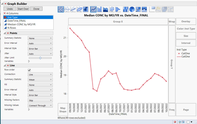

txnelson
The issue should be resolved if you drag the column you are using as the Color option, to the Overlay box.  It will then treat each grouping as separate groups.
