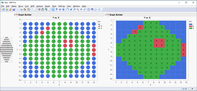

I cannot share the code I use but here is a quick example with some ideas
Names Default To Here(1);
// load text file
// parse interesting things
// get map to string
map_str =
".....GGG.....
....BGGGG....
...BGGGGGG...
..GGGGGGGGG..
.GGGGGGBBGGG.
GGGGGGGBBGGGB
GGGGGGGGGGGGB
GGGGGGGGGGGGB
.GGGGGGGGGGG.
..GGGGGGGGG..
...GGGGGGG...
....GGGGG....
.....GGG.....";
l = Words(map_str, "\!N");
rowc = N Items(l);
colc = N Items(Words(l[1], ""));
dt = New Table("Untitled",
	Add Rows(rowc * colc),
	New Column("X", Numeric, Continuous),
	New Column("Y", Numeric, Continuous),
	New Column("bin", Character, Nominal, Label(1))
For Each({line, idx}, l,
	cur_rows = ((idx - 1) * colc::(idx * colc - 1)) + 1;
	dt[cur_rows, "X"] = ((1::colc))`;
	dt[cur_rows, "Y"] = (J(1, colc) * (idx))`;
	dt[cur_rows, "bin"] = Words(line, "");
nw = New Window("test",
	H List Box(
		align("center"),
		Text Box(map_str, <<Set Font Name("Courier New")),
		dt << Graph Builder(
			Size(529, 457),
			Show Control Panel(0),
			Variables(X(:X), Y(:Y), Color(:bin)),
			Elements(Points(X, Y, Legend(9))),
			SendToReport(
				Dispatch(
					"X",
					ScaleBox,
					{Min(0.461038514127673), Max(13.543406057392), Inc(1), Minor Ticks(0),
					Label Row(Show Major Grid(1))}
				Dispatch(
					"Y",
					ScaleBox,
					{Min(14), Max(0), Inc(1), Minor Ticks(0), Label Row(Show Major Grid(1))}
				Dispatch(
					"400",
					ScaleBox,
					{Legend Model(
						9,
						Properties(0, {Marker Size(20)}, Item ID(".", 1)),
						Properties(1, {Marker Size(20)}, Item ID("B", 1)),
						Properties(2, {Marker Size(20)}, Item ID("G", 1))
			Size(529, 457),
			Elements(Heatmap(X, Y, Legend(10), Label("Label by Value"))),
			SendToReport(
				Dispatch({}, "X", ScaleBox, {Min(0.461038514127673), Max(14.3842387539345), Inc(1), Minor Ticks(0), Label Row(Show Major Grid(1))}),
				Dispatch({}, "Y", ScaleBox, {Min(14.3060372430966), Max(0.789075991529451), Inc(1), Minor Ticks(0), Label Row(Show Major Grid(1))})
-Jarmo

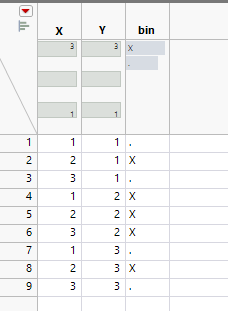

Using simpler table
// Simple example table
dt = New Table(
	"Untitled",
	Add Rows(9),
	New Column("X", Numeric, "Continuous", Format("Best", 12), Set Values([1, 2, 3, 1, 2, 3, 1, 2, 3])),
	New Column("Y", Numeric, "Continuous", Format("Best", 12), Set Values([1, 1, 1, 2, 2, 2, 3, 3, 3])),
	New Column("bin", Character, "Nominal", Set Values({".", "X", ".", "X", "X", "X", ".", "X", "."}))
//empty string initialization
str = "";
// get unique values for Y
// I will use Associative array instead of Summarize to keep correct format of values
// Summarize would change them to strings
y_uniq = Associative Array(:Y) << get keys;
For Each({cur_y}, y_uniq,
	cur_line_rows = Loc(dt[0, "Y"], cur_y); // Loc() with datatable subscripting
	line_bins = dt[cur_line_rows, "bin"]; // more datatable subscripting
	bin_str = Concat Items(line_bins, "");
	str = str || bin_str || "\!N";
// remove extra whitespace
str = Trim Whitespace(str);
Write(str);
-Jarmo

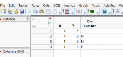

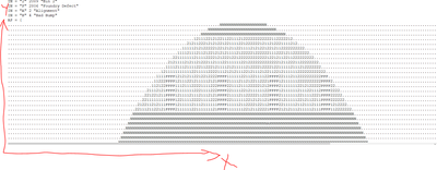

I want to store the die location and the letters in the jmp data table columns X and Y from the attached text file. How to use JSL to process such txt file as tabular data?
JMP table:
// load text file
map_str =
".....GGG.....
....BGGGG....
...BGGGGGG...
..GGGGGGGGG..
.GGGGGGBBGGG.
GGGGGGGBBGGGB
GGGGGGGGGGGGB
GGGGGGGGGGGGB
.GGGGGGGGGGG.
..GGGGGGGGG..
...GGGGGGG...
....GGGGG....
.....GGG.....";
rowc = N Items(l);
	H List Box(
		align("center"),
			Size(529, 457),
			SendToReport(
				Dispatch(
					"X",
					ScaleBox,
				Dispatch(
					"Y",
					ScaleBox,
				Dispatch(
					"400",
					ScaleBox,
					{Legend Model(
						9,
			Size(529, 457),
			SendToReport(
-Jarmo
Jackie_
Level VI
Re: Import x and y values from the text file to jmp table and create wafer map
It works like charm. Thanks alot @jthi,

Using simpler table
dt = New Table(
	"Untitled",
	Add Rows(9),
str = "";
Write(str);
-Jarmo
