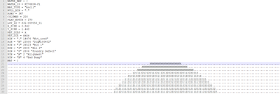

Your approach works if the pattern in the first row matches with the contain statement. I have several wafer maps which won't have same patterns. The only similarity is the wafer pattern starts at row number 21 in the text file. Is there a way to define the row number where the script will start reading?. I have attached a wafer map text file for reference (better view on note pad ++)

Re: Import x and y values from the text file to jmp table and create wafer map
You could try Contains with "MAP = {". This should give you the location of "MAP = {" in the string and then use that knowledge with Substr to get what you want
-Jarmo
