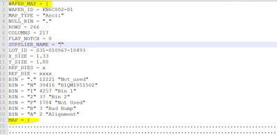

@jthi
There are two strings containing "MAP = {" highlighted below:
I tried using & statement to not select first one but it doesn't work.
demo_str = Load text file("New wafer map.txt");
a = Contains(demo_str,"MAP = {") & Contains(demo_str,"WAFER_MAP = {") ==0; // get the location of the string "MAP ={"

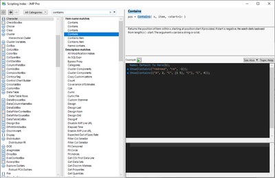

You can use Contains to skip first "MAP = {" or search from end (read scripting index...)

Again, reminder to use scripting index and jmp help. They are usually best resources to learn this type of JMP Scripting
