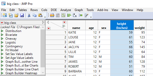

When I make a summary table from the tabulate option, the units from the column do not show up in the table. Only the column label is displayed.
I could write the units by hand into the column label but I wonder if there is a more elegant solution?
Thanks
txnelson
Re: Import Column units into new table with JSL

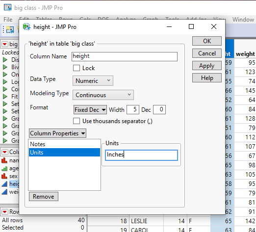

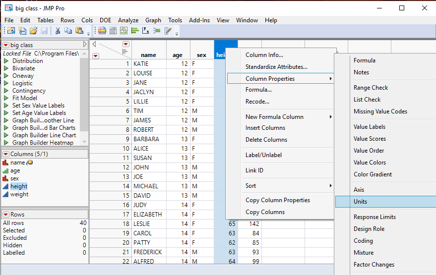

The column's units are not part of the column name.  They are a separate column property, called "Units".  What you need to do, is to go to the newly created data table.  Then right click on the column header and select
     Column Properties==>Units
Type the units into the dialog box that is displayed, and then click on OK.
The Units will then be displayed at the end of the Column Label
