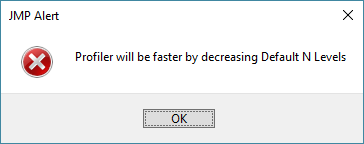

I'm creating a rather large Profiler plot with many fits and standard error formulas. JMP keeps telling me "Profiler will be faster by decreasing Default N Levels".
I have aleady reduced the default n levels in JSL that creates the plots to a level that I don't want to go below. Is there a way to ignore this alert window? I accept profiler will be a bit sluggish and I'm ok with it. I don't want this to keep popping up repeatedly.
Alternatively, is it possible to send a "press OK" command using JSL to that window? I could add that after my profiler plot generating code.

You may be able to bypass the displaying of the window, by setting a little known function.
batchinteractive(1)
I would not bet any money on it, but it may work

Worked like a charm!
Quick note for others who need this solution:
Add a "Batch Interactive( 0 )" somewhere appropriate along the execution afterwards. Otherwise it's not possible to quit JMP. I just surrounded my profiler code with "batch interactive(1)" and "batch interactive(0)".
