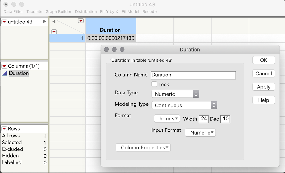

Hi @Sciguy_1,
I suspect this is in part due to the number of decimal places you are showing. In the attached example I changed to 10 in the Column Properties for my duration column (see below).
But, I'm a little confused about why you expect 0.000021713 to come out formatted as 0:01.9. Is your numeric value not in seconds? If it's something else I'm sure we can figure out a transformation to get it into a format JMP is expecting.
