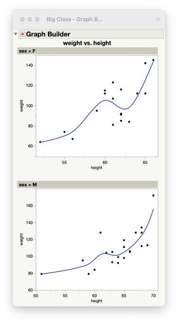

In the following graph, I want to be able to identify the page titles:
i.e. "sex = F" and "sex = M".

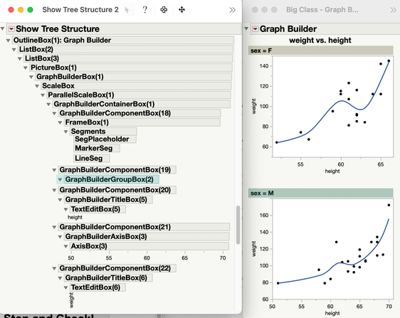

Looking at the display tree it would appear that the titles are associated with a display box of type GraphBuilderGroupBox:

Wow! That is one uncooperative box! Try using rep<<getJournal and hunting for LabelBox(label(\!"sex = F\!") stuff. At least in JMP 16, for the simple big class example, the LabelBoxes in the journal and the GraphBuilderGroupBoxes  seem to run in parallel.
@XanGreggthe box in question transforms itself into something friendlier when journaled. But in isolation, in the live graph builder, it won't say anything about itself.
