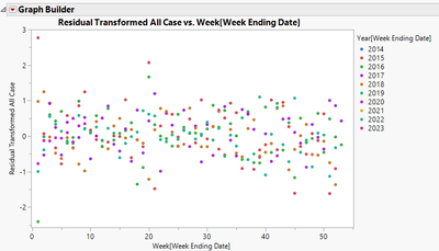

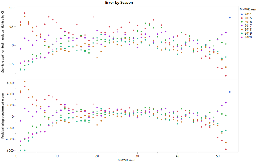

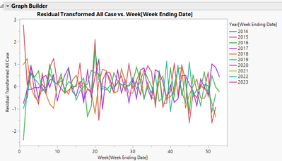

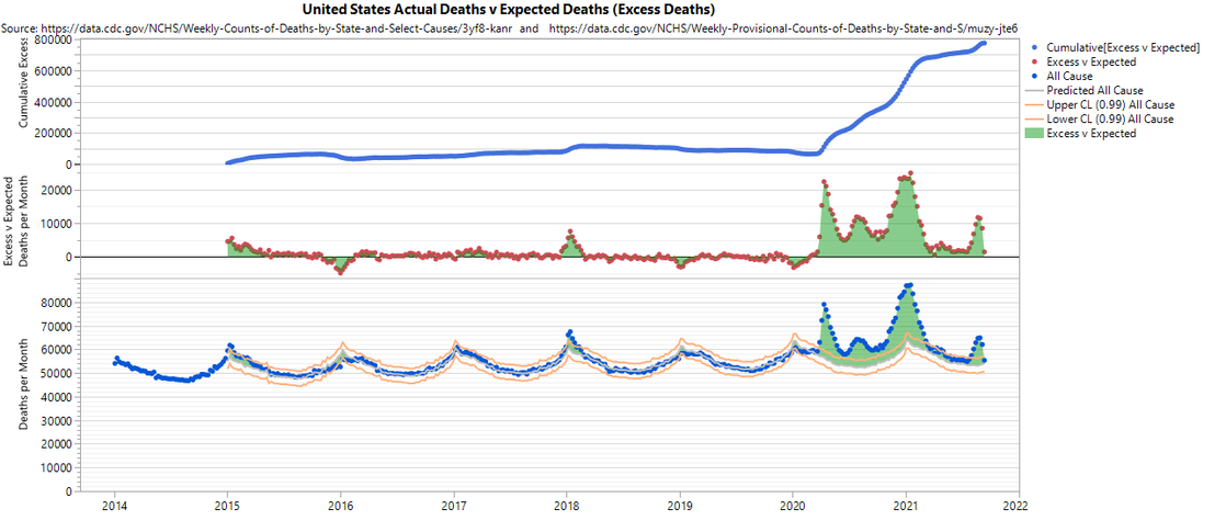

A time series (seasonal ARIMA) model for varying variability in different seasons
Is there a time series ARIMA model that can represents increased variation (expand confidence intervals) in values during one season?
As an example, attached is a data set showing the number of deaths in the United States.  A time series analysis of deaths prior to March of 2020 (settings below) gives a reasonable prediction of deaths, however its accuracy is reduced during Dec - Feb (flu season and dead of winter).  The error bars around this model do not increase during that season, so while relatively few points on the whole graph are outside the CI, 5 out of 6 years have points out of the expected range in Dec or Jan, and no points are out of range during any other season.
I think the confidence interval should be smaller in the summer and wider in the winter.  Is there a better model to represent this data? A simple linear regression of week x values from previous years would show this increased variation but I feel like something in the time series platform should be able to help.
See the confidence intervals (orange lines) in the bottom of the chart below, and note how prior to 2020 the blue dots (actual deaths) are often out of that range near the start of each year.
Settings for the time series model used to draw this graph:
Time Series(
	X( :Week Ending Date ),
	Y( :All Cause ),
	Autocorrelation Lags( 52 ),
	Forecast Periods( 52 ),
	Seasonal ARIMA( 0, 0, 0, 1, 1, 1, 52, Prediction Interval( 0.99 ) ),
	SendToReport(
		Dispatch( {}, "Time Series Basic Diagnostics", OutlineBox, {Close( 1 )} ),
		Dispatch( {"Model Comparison"}, "", ScrollBox, {Background Color( 117 )} )
You can recreate this data table, or see it for an individual state, using the script below.  Download the data (export as csv and save to your computer) from here:
https://data.cdc.gov/NCHS/Weekly-Counts-of-Deaths-by-State-and-Select-Causes/3yf8-kanr
https://data.cdc.gov/NCHS/Weekly-Provisional-Counts-of-Deaths-by-State-and-S/muzy-jte6

I feel like I've exhausted possible box cox transformation and while they improve the prediction (more values in winter are within the confidence interval), but I don't feel like this is going to get me to a model with realistic errors bars in the winter.  Using the platform options in time series didn't seem to help very much but using the cube root of (deaths - 45000) gives a fairly normal distribution. Even using this as an input though there is still way more value outside the confidence interval in the winter than in the summer.
Transformed
Seasonality of residuals, both raw (on bottom) and 'standardized' by dividing them by the confidence interval (top). Note how the top chart looks better, but that is still a prominent pattern.

Using your transformation, I fit a different model Seasonal ARIMA(4, 0, 4)(1, 1, 1)52, and this is the overlay residual plot I get.
This is what they look like if I connect the dots:
Variances still suspiciously seem clustered by seasons. But there may not be anything that ARIMA can do about it. Here are some thoughts:
