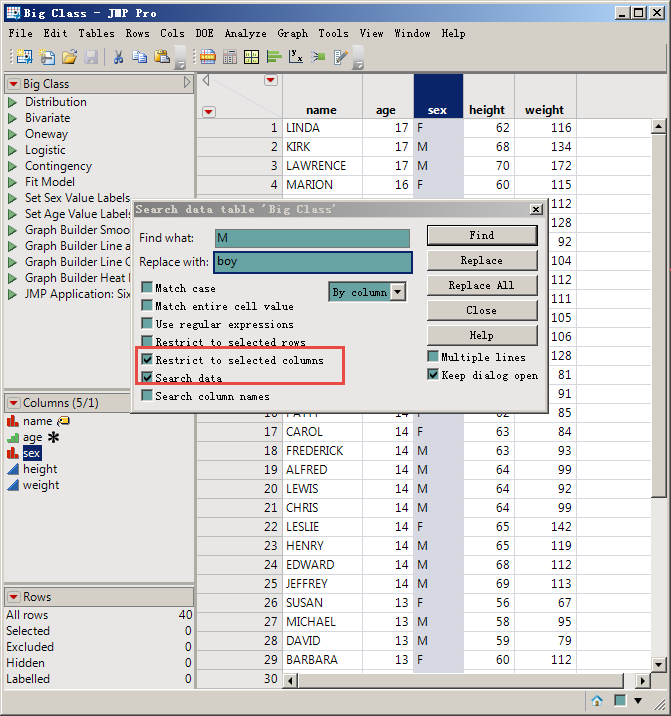

I can't even do this simple replace!
Not found in the script index, please finish with JSL.Thank you very much!

You could use data table subscripting:
NamesDefaultToHere(1);
Wait(3);
maleRows = Loc(dt[0, "sex"], "M");
dt[maleRows, "sex"] = "boy";

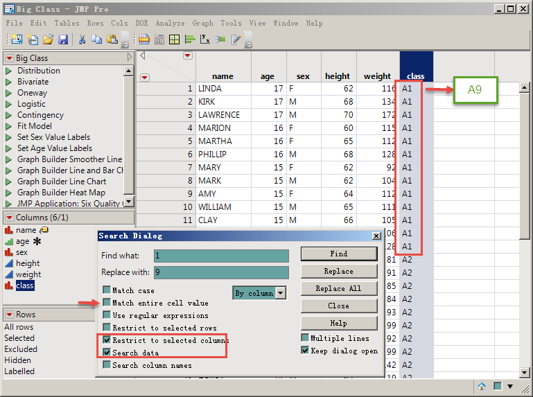

I've tried to write JSL in a way that only works with perfectly matched substitutions, but if you don't want to replace only a few characters, how do you write JSL?Thank you!
txnelson
Re: I can't even do this simple replace!
This is one way to do it
dt = Current Data Table();
dt:class[dt << get rows where( dt:class == "A1" )] = "A9";
Jim

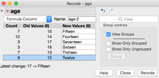

If I understand correctly, consider using the 'Match()' JSL expression. I generated the code below by using 'Cols > Recode':
and inspecting the JSL for the resulting formula column. And, 'yes', JSL is very different from VBA. You should look at 'Help > Books > Scripting Guide' and/or consider some training.

I'm so sorry!Maybe the example I gave is not appropriate and misleading.
I just want to replace some of the specified characters with others in the same column.That is the manual interface function, just want to use JSL implementation.
The VBA implementation in excel is simple:Selection.Replace What:="1", Replacement:="9", LookAt:=xlPart
I just want the effect of this simple trade effect.But I don't have the corresponding code in JSL.Thank you!

This is the result of the substitution in the case of "Match entire cell value" the multiple checkbox is not selected.Thank you!
lwx228
Level VIII
It's just a matter of replacing some characters in a cell with JSL.
