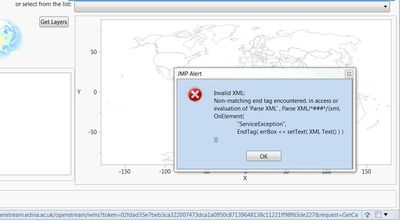

Re: I am having trouble getting any reliable background map to appear, including all WMS link I've tried and the NASA server.  Can anyone please help me find a high resolution map of Scotland that I can use as a background map image?
Hi John,
I had everything running well.  I went in and deleted to rows from my database and now no background wms will shop up.  It's very strange; I had it sorted and now I'm getting this response:
JohnPonte
Staff (Retired)
By the way - deleting some rows shouldn't break the background map. The only connection might be that the data will define the axes and the axes will define the bounding box in the map request. If deleting the rows caused an issue, I would plot the data in Graph Builder (or some other graph platform) and look at the axes that you get. Make sure you are using latitude for the y-axis and longitude for the x-axis and make sure the min and max values for both axes make sense.
From your picture, it looks like the Add-In was having trouble parsing the response from the server. It may be because the server threw an exception instead of the anticipated result or it may be that the Add-In just isn't handling the response properly. Unfortunately I haven't updated the Add-In in quite awhile and it may be out of date with recent versions of the WMS API. If you are having trouble with the Add-In, I would recommend just trying to use JMP. Open your data table and bring up something like Graph Builder or Bubble Plot. Then set the background map option in the graph. The Add-In is attempting to query the WMS server for information and then parse the response. A graph in JMP doesn't need to do that. It will just request a map and display it.
