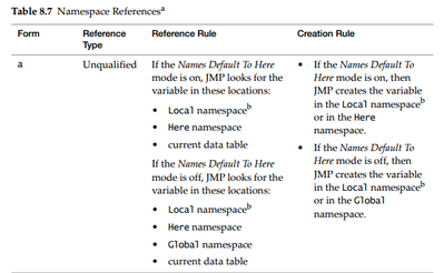

Same goes with local:x if you'd rather explicitly scope on the fly.
f = function({}, {},
       x = "global scope replaced";
       local:x = "function scope x";
       local:y = "function scope y";
       print(::x, local:x,  y);
f();
You have to remember to call ::x explicitly because of the scoping rules for unscoped variables.
