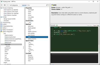

Saving can be done with save method of DataTable

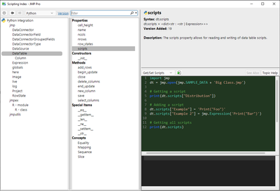

To add table scripts you can use either run_jsl or scripts with jmp.Expression
