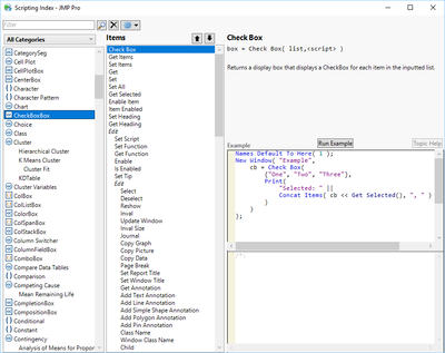

txnelson
Re: How to work with checkboxes?
I will point you to:
    Help==>Scripting Index
There, when you scroll down to:
     CheckBoxBox
and click on it, you will get all of the items that you can ask for, or pass to a check box, along with examples(code snipppets) for each
Jim
