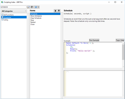

You can either use an operating system scheduler program which will run a JMP pgm, or you can startup a JMP session and run a JMP script that uses the Schedule() function.
Here is the output from
Help==>Scripting Index==>schedule
Jim
