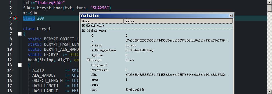

  • I didn't install python and ended up using AutoHotkey code
