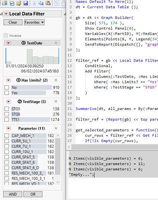

@jthi using my data table exampleSummaryTableNoLimsNew.jmp, the following appears to work as expected (I have manually checked the data table and outputs). How does one proceed from this to my actual problem where the data filter is within the Graph Builder. I find associative arrays very confusing so requesting some help here.
Names Default To Here(1);
clear log ();
dt = Current Data Table();
obj = dt << Data Filter(Conditional,
Add Filter(columns(:TestDate, :Has Limits?, :TestStage, :Parameter) ),
Mode(Select(0), Show(0), Include(1))
Summarize(dt, all_Parameters = By(:Parameter));
show(all_Parameters);
// Change filter value at this point and run the code below
cur_rows = obj << Get Filtered Rows;
visible_Parameters = Associative Array(dt[cur_rows, "Parameter"]) << get keys;
Show(N Items(all_Parameters), N Items(visible_Parameters));

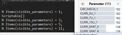

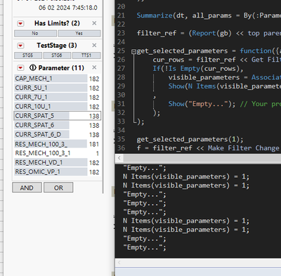

get_selected_states = function({a},
cur_rows = filter_ref << Get Filtered Rows;
If(!Is Empty(cur_rows),
visible_states = Associative Array(dt[cur_rows, "State"]) << get keys;
Show(N Items(visible_states));
Show("Empty..."); // Your problem, you should have all states visible here
get_selected_states(1);
f = filter_ref << Make Filter Change Handler(get_selected_states);
@jthi Thanks. Your last script works when I run it and results are as expected with JMP Sample Data (true for all your scripts so far). The reason I used my data table is because I thought the data form I have could be causing my issue.
I am afraid, I am a bit lost now with all the different scripts on the table.
What is returned can be a bit finicky in my experience (especially when nothing/everything is selected). Next you would have to figure out what to do in those situations and then you should be able to modify my earlier script.
