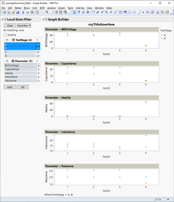

Attached is an example data table. The script below tries to plot each parameter selected via the Local Data Filter in a new "Page" in Graph Builder. As it stands, the y-axis title is shown as "Median" every time a new "Parameter" is selected via the Local Data Filter.
I would like the Parameter name to be the y-axis title when new a parameter gets selected and plotted on a new "Page".
I tried using the filter change handler for this, but my script does not quite work. I think I need the index below to be updated each time a new parameter is selected or may be there is another way. Any direction will be useful.
XPath( "//TextEditBox" ))[i]

Everything works as expected except the initial charts do not have the correct Y Axis title. Y axis title becomes correct only after another TestStage is selected. Is my placement of
update_title(local_filter);
correct or should it be placed somewhere else?

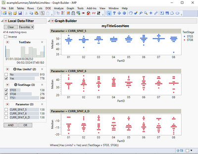

However, I was able to reproduce part of the issue I am facing with my actual data by creating another data table which more closely matches with my actual data. Data table is attached and using the script below

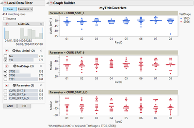

I get the following when no Parameters are selected,
and this one after selecting all Parameters and unselecting them again. Here the top chart only gets the correct y-axis label.
Hopefully if these get resolved, my actual data case will start working as expected as well. Any direction would be very useful.

This check is causing the issues.
There are more filters which can cause a situation when not all parameters are visible. One option would be to use << Get Filtered Rows and calculate which parameters are visible instead of just assuming all of them are.

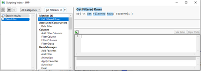

@jthi Thanks but my Scripting Index (JMP 16.2) does got give any example on how to use << Get Filtered Rows.
Could I get some help on how to use it in my case?
