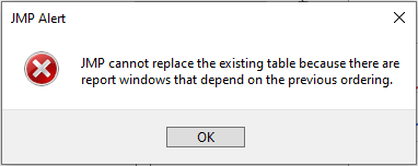

This code performed as expected when there are no graphs open:
  Untitled = data table("Untitled.jmp");
  if( N rows(Untitled) > 0, Untitled << sort(by(:name("Column 1")), Order( Ascending ), replace table(1)));
But the sort fails to work if you have any graphs open,
 Untitled <<Distribution( Continuous Distribution(Column( :Column 1 )));
   if( N rows(Untitled) > 0, Untitled << sort(by(:name("Column 1")), Order( Descending ), replace table(1)));
Look at the log file and we see:
JMP cannot replace the existing table because there are report windows that depend on the previous ordering.
But if we remove replace table, it will execute without error but it will launch a new datatable with the sorted rows which is not desired.
   if( N rows(Untitled) > 0, Untitled << sort(by(:name("Column 1")), Order( Descending )));
So you can check the log file to see if it is informative. If you have any dependent graphs or tables open, maybe you need to rethink the logic of the script. Is it possible to re-sort before making dependent tables and graphs, for example.

Hi, what is the official way to sort a data table via JSL with the option ReplaceTable()?
As discussed before, If there are open Reports, the script crashes with the error message:
... even if the graph doesn't depend of the ordering in the data table:

How about replacing the text with something like:
Unfortunately, in the current version of Jmp, there is no chance to sort a table with open reports.
Jmp cannot replace the existing table because there is some chance ... hm, you know, report windows might depend on the previous ordering. Unfortunately, there is no option to check that - and there is no option to ignore it. So the Script will stop here.
