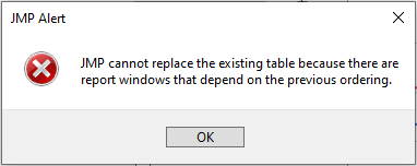

When a user want to add new rows to a data table or when he wants to sort the data table there is a risk that this is not possible in Jmp due to open reports.
How to update table after sorting?
Worst case: The JSL script just stops with an error message telling the user:
Often the report has no issue with the ordering or the rows, it just needs a refresh.

With the current behavior of Jmp some actions like adding rows or sorting data tables are not possible when a report is open.
