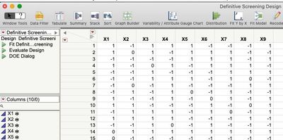

You can't use the response surface macro and you must ensure the block is not a random effect.  To create the model, you will need to understand the total degrees of freedom available and the aliasing in your experiment.  (Never put aliased terms in the model, you will get singularity errors).  You might start here:
https://www.jmp.com/support/help/en/16.2/?os=mac&source=application&utm_source=helpmenu&utm_medium=a...
When you create the design in JMP, you should get an arrow that is a script to Evaluate Design, this will provide the aliasing structure.  If you have run a complete block, your model will contain the definitive screening design model, block and all block-by-definitive screening model effects.

Re: How to treat replicates and failed runs in a definitive screening design
You do not have the same option with a DSD. You cannot replicate some runs if you want to use Fit Definitive Screening. You can copy all the runs after you click Make Table, and paste a copy below the original rows to replicate the design.
Victor_G
Hi @SaraA,
As @Mark_Bailey has mentioned, you can replicate manually the full design by copy-pasting all the rows belonging to the DSD.
You can also use the platform Augment Design to replicate your DSD : Replicate a Design
