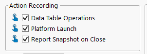

I'm not sure if there are any specific methods of suppressing the report snapshot (except modifying preferences (do not do this in your script for any other user than yourself)). Depending on your script you might be able to close the chart with << close window if you wrap it in new window

You can also modify your preferences but do not do this in your script for any other user

Yeah, those "Action Recording" options and the Enhanced Log are seriously annoying and inconvenient.

We should at least be able to add
Report Snapshot On Close(0)
when we launch platforms to prevent the actions from reports being recorded. Or some other way of controlling them, maybe even session level setting a bit like Names Default To Here(1) (maybe I make a wish list item out of this).
