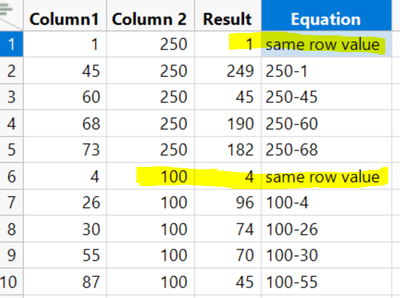

How to subtract values from previous row values?
Hi all
Can someone help me how to formulate a formula that would subtract Column 2 to the previous value in Column 1? It should look like this. The column Equation only shows how the subtraction of values should be.TIA
David_Burnham
Super User (Alumni)
Re: How to subtract values from previous row values?
Then you need some conditional logic.  Something like:
If( :Column 2 != Lag( :Column 2, 1 ) | Row() == 1,
	:Column 1,
	:Column 2 - Lag( :Column 1, 1 )
-Dave

David_Burnham
Super User (Alumni)
You can use the LAG function:
:Column 1 - Lag( :Column 2, 1 )
-Dave
