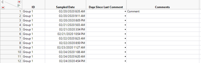

I am trying to calculate a Date Difference in Days between the current row and the last row where a comment is non-missing. Any help greatly appreciated!
If( (:ID == Lag( :ID ) | Row() == 1) & !Is Missing( :Comments ), 0,
Date Difference( :Sampled Date, Lag(:Sampled Date, n=last row where !Is Missing(:Comments)), "Day" )

Here is the formula that I would use for the calculation
If( Row() == 1 | :ID != Lag( :ID ),
	lastCmtDate = .
If( :Comments != "",
	lastCmtDate = :Sampled Date
:Days Since Last Comment = (:Sampled Date - lastCmtDate) / In Days( 1 );

If the table is always sorted by date you could do this with two columns, as shown below.
New Column( "Last Comment Date",
	Numeric,
	"Continuous",
	Format( "m/d/y h:m", 19 ),
	Input Format( "Monddyyyy h:m" ),
	Formula(
		If(
			Row() == 1, :Sampled Date,
			:Comments == Lag( :Comments, 1 ), Lag( :Sampled Date, 1 ),
			:Sampled Date
	Set Display Width( 136 )
New Column( "Days Since Last Comment New",
	Numeric,
	"Continuous",
	Format( "Best", 12 ),
	Formula( (:Sampled Date - :Last Comment Date) / (3600 * 24) ),
	Set Display Width( 109 )

Thanks ih, but this doesn't work. The new column you created is not populated with the date of the last comment, just the lag sampled date. Thanks for trying!

Thank you! This worked!
