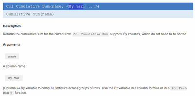

jthi
Re: How to properly use LAG function in Conditional Statements?
By vars are arguments which you can use with Col statistical functions Statistical Functions (jmp.com)

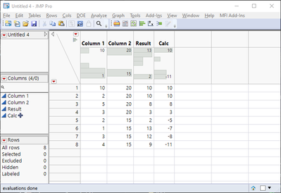

Names Default To Here(1);
dt = New Table("Untitled 4",
	Add Rows(8),
	Compress File When Saved(1),
	New Column("Column 1", Numeric, "Continuous", Format("Best", 12), Set Values([10, 2, 5, 3, 2, 1, 3, 4])),
	New Column("Column 2", Numeric, "Continuous", Format("Best", 12), Set Values([20, 20, 20, 20, 15, 15, 15, 15])),
	New Column("Result", Numeric, "Continuous", Format("Best", 12), Set Values([10, 10, 8, 3, 2, 13, 12, 9]))
dt << New Column("Calc",
	Numeric,
	Continuous,
	Formula(
		If(Row() == Col Min(Row(), :Column 2),
			:Column 1
			:Column 2 - Col Cumulative Sum(:Column 1, :Column 2) + :Column 1
-Jarmo

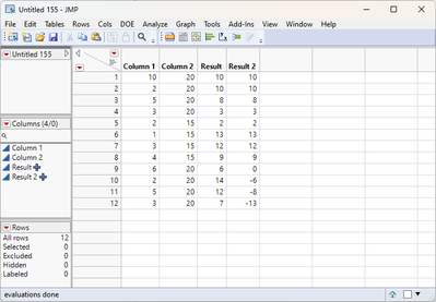

@UserID16644, if your :Column2 ever has the same value again, you'll get undesired results.
New Table( "Untitled 155",
	Add Rows( 12 ),
	New Column( "Column 1",
		Numeric,
		"Continuous",
		Format( "Best", 12 ),
		Set Values( [10, 2, 5, 3, 2, 1, 3, 4, 6, 2, 5, 3] )
	New Column( "Column 2",
		Numeric,
		"Continuous",
		Set Values( [20, 20, 20, 20, 15, 15, 15, 15, 20, 20, 20, 20] )
	New Column( "Result",
		Numeric,
		"Continuous",
		Formula(
			If(
				:Column 2 != Lag( :Column 2 ) | Row() == 1, :Column 1,
				Row() == 2 | Lag( :Column 2, 2 ) != :Column 2,
					:Column 2 - Lag( :Column 1 ),
				Lag( :Result ) - Lag( :Column 1 )
	New Column( "Result 2",
		Numeric,
		"Continuous",
		Formula(
			If( Row() == Col Min( Row(), :Column 2 ),
				:Column 1,
				(:Column 2 - Col Cumulative Sum( :Column 1, :Column 2 )) + :Column 1
