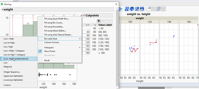

What a wonderful feature: custom labels !
I tried to reproduce the steps in the screenshots with Jmp 17.1.0 - but once I change something in the binning scheme or the Bin Label Style, the displayed labels switch to "single number only" - independent of the  Bin Label Style settings.
This is how it looks after pressing "OK" and opening the menu again:

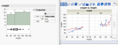

Jmp support confirmed that this is a known bug in Jmp 17.1 - th same if you try to use custom labels:
According to the settings on the left, it should be "low" and "high" but in the plot actually it is "64" and "100":

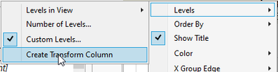

Workaround at the moment:
"save" the user define binning as a Transform Column and use that column.
the disadvantage: the user loses the ability to adjust the settings via Right Click/ Custom Labels ...
