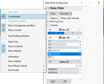

conditional data filter + invert selection: bug?
When a data filter is configured to be conditional, selections in one filter affect the values which are displayed in other filters:
When the user opens the red triangle menu and clicks on clear selection, the filter is reset and the other filters are adjusted accordingly.
Surprising
When the user opens the red triangle menu and clicks on invert selection, the selection is just inverted, but none of the other filters is updated.
Is this behavior just on my system?
Not just because of this behavior ...

Names Default to Here(1);
Current Data Table() << Data Filter(
	Location( {751, 160} ),
	Conditional,
	Mode( Select( 0 ), Include( 1 ) ),
	Add Filter(
		columns( :sex, :age, :name ),
		Where( :sex == "F" ),
		Where( :age == 16 ),
		Display( :age, N Items( 6 ) ),
		Display( :name, N Items( 15 ), "List Display", Find( Set Text( "" ) ) )
// now go to "age"(red triangle menu) and invert the selection

jthi
Re: conditional data filter + invert selection: bug?
Seems like a bug so I would report it to [email protected]. Change does happen in the table but won't update the filters latter filters

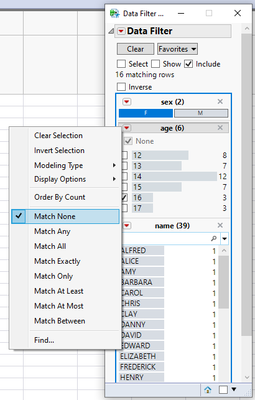

A simple workaround for this bug could be:
Change the modeling type to Multiple Response and use "match none".

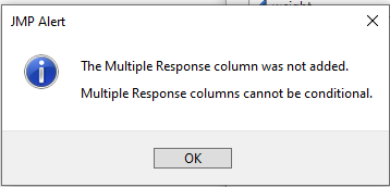

Unfortunately, Jmp says that Multiple Response columns cannot be conditional.
Couldn't they? I wish they could ...
