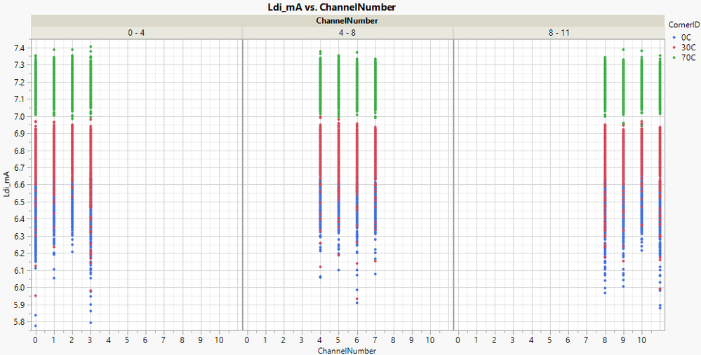

2021-11-29 10_52_16-Untitled 18 - Graph Builder - JMP.pngHi,
In the attached plot, the property of column "ChannelNumber" is Numeric/Continuous. I found it confusing in the grouped values at the top. "0-4" actually includes 0-3, as shown at the bottom; "4-8" actualy includes 4-7. It seems the range at the top always has overlapping values between adjacent levels. What can I do to make this overlap go away (i.e. I want it to show "0-3", "4-7","8-11" at the top)? Thank you very much...

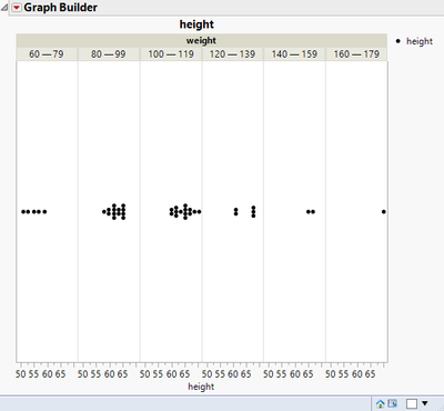

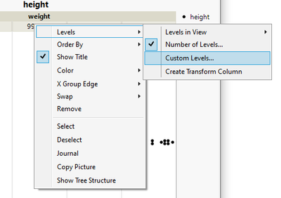

If you have JMP16, you could create Custom Range:

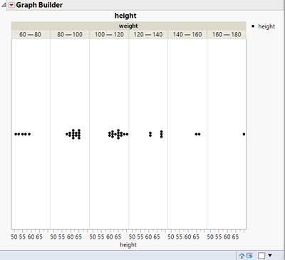

Or in this case it might be enough if you just change the Bin Label Style from Cutpoints red triangle in same Custom Levels menu.
Default:
Using Low to high - 1
-Jarmo

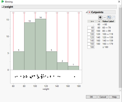

Thanks, but I am using JMP14. There is no "Custom Levels" option. The closest I can get it to add a Binning column:
Any other ideas please?

Unfortunately, I don't have JMP 14 to hand to check - But if you right click on 'ChannelNumber' in the Graph Builder display immediately above, do you see some options that allow you to control the number of levels displayed?
Re: How to show the actual range in the level values in Graph Builder?

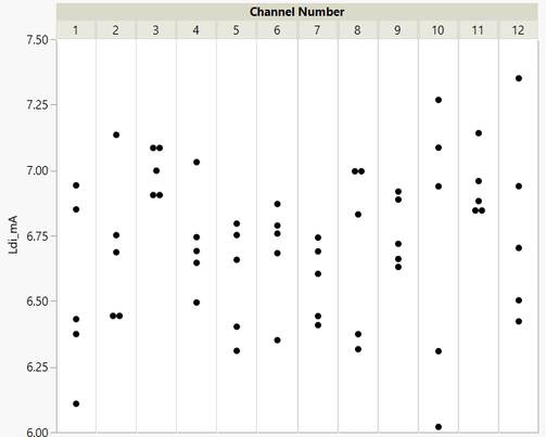

I do have version 14. If you right-click on the channel number, select Number of Levels. From your first example, that would be 12 levels. Not sure why yours defaulted to 3 levels as mine defaulted to all levels.
I made a simple example, and it looks like this (as a scatterplot rather than boxplot).

Thanks Dan. I was trying to make the ChannelNumber into 3 equal groups, as in 0-3, 4-7, 8-11. Number of Levels to display was set to 3. My original question was how to make it show "0-3","4-7","8-11" at the top, instead of "0-4","4-8","8-11", without adding another column.
