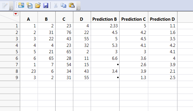

For every column that contains a word, say "Prediction", I want to extract top 3 cell values either greater than 5 or greater than 4.5 (if I get 3 numbers above 5 then I dont want any numbers above 4.5) in a list. Further, picking the one that is farthest away from 5 and hide the corresponding cell value in its raw table. For example, in this example table given below:
In Prediction B column, I want to store 6.6, 5.3 and 5. And hide the cell adjacent to Prediction B nut in Column B i.e. cell value 65.
My code selects columns which have the string "Prediction" in it.

I don't even want to exclude an entire row. I want to exclude only cells. For Example, in the table I have posted, I want to be able to exclude the cell in column "B" that is adjacent to the cell that has value 6.6 in column "Prediction B". I am still struggling to figure how I can use regex to match such strings. I have made 2 lists, one which contains col names that have the word "Prediction" in them and another that dont. I would appreciate if you could also point me out to any function you think would work out best with such type of tables. I have just started working with JSL and I am still struggling with it. Thanks in advance for the help. @uday_guntupalli
