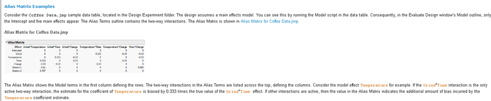

Able to explain to me what does the 'Temperature is biased by 0.333 times the true value of the grind*time? Does it mean that the parameter estimates for temperature is 1/3 value of the grind*time estimates?AliasMatrix.PNG

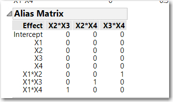

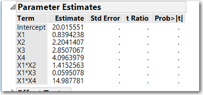

For another example, I have attached 4-factor fractional factorial. The screenshot below displays the alias matrix. The response Y was created from the formula
20 + 1*:X1 + 2*:X2 + 3*:X3 + 4*:X4 + 0.5*:X12 + 1*:X34 + 5*:X13 -5*:X24 +5*:X14 +10*:X23 + 1*Random Normal()
Since X12 (simpler notation) is confounded with X34, and only X12 is in the model, it's coefficient should be approx. 1.5. And since X13 and X24 are correlated the coefficient of X13 will be approx. 0, and the coefficient of X14 will be approx. 15.  This is why checking the evaluating the design which includes checking the alias structure is an important step in designing an experiment. If there is an expected important interaction, the design should be chosen so it has no confounding with other 2 factor interactions, or small partial interactions with multiple effects.

The correlation of 0.333 means that the estimated effect of Temperature is increased by the effect of the gind*time-interaction multiplied by 1/3. So basically you are estimating in the analysis
[Temperature] = Temperature + 1/3*Grind*Time
Thus if there is a strong interaction effect it will inflate your main effect estimator.

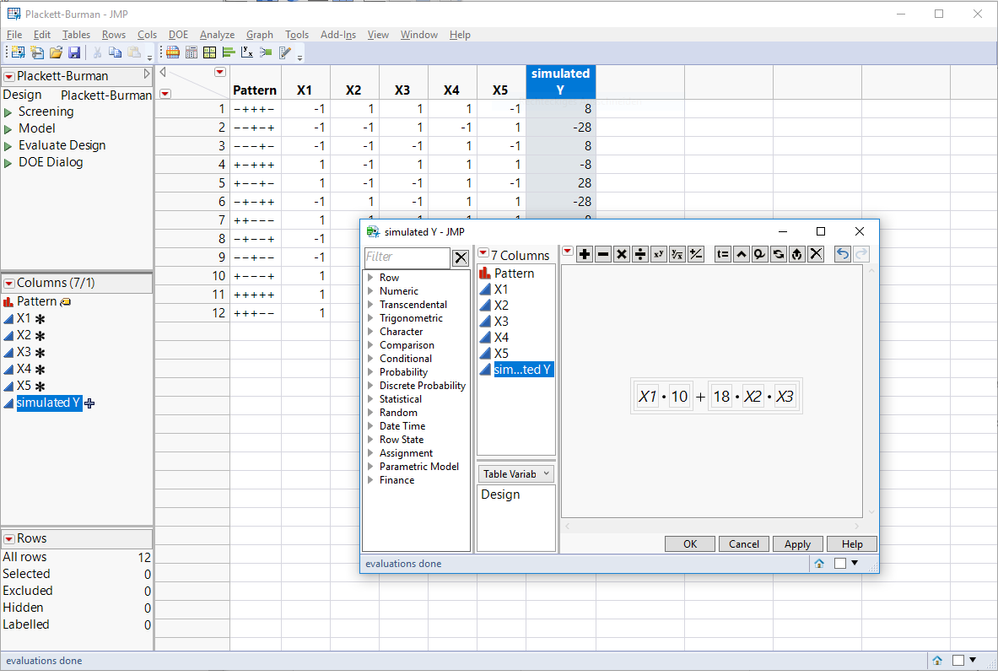

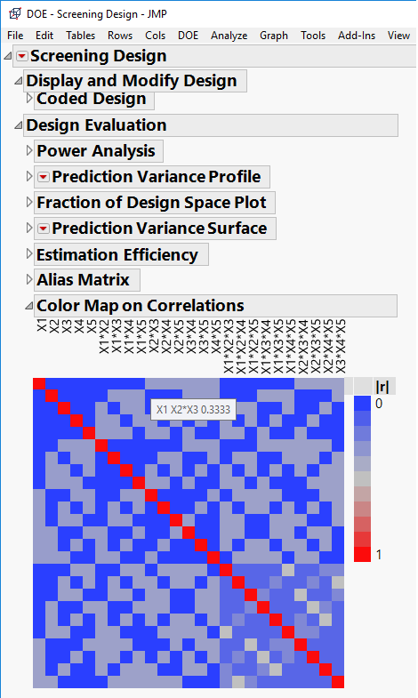

You can see that by simulating some simple data. For demonstration purposes I will use a Plackett-Burrman screening design with the following correlation structure:
As you can see the main effect X1 has a correlation of 0.333 with the X2*X3-interaction. I generated the design and added some simulated data:

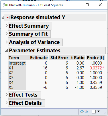

As you can see, the true effect of X1 = 10, the true effect of the interaction X2*X3 = 18. If we now fit a main effects model you get the following results:
The estimated effect of X1 = 16, which is the true effect of X1 - which is 10 - and it is biased by 1/3*18 (the effect of X2*X3).
