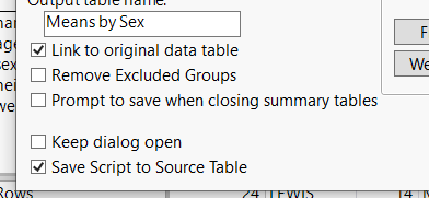

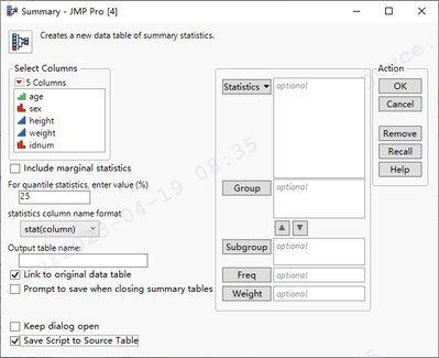

There is an option in the lower left corner of the Summary dialog to "Save Script to Source Table". So you just need to check this option when you create the summary table and then save the source table for sharing with your colleagues.
If you wanted, you could adapt the saved script so that it runs and creates the summary table when the source table is opened. Just rename the saved script "On open".  Phil_Kay_1-1681811699868.pngPhil_Kay_1-1681811699868.png

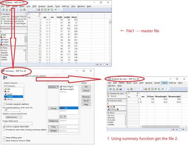

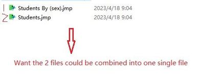

Thank you for your detailed feedback,I add some graph for further explain. Can you kindly to help it?
Because I often use the summary function to do some analysis, its better to send the single one instead of separated files, especially there are already a few master files,  plus other new generated one... too many files...

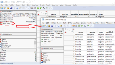

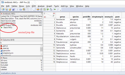

P.S. I found there was a case in the help----it has a nested script(run --- Pop a jmp window), I want to know how it was realized...
