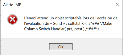

Here is the message I got:
"The send expects a scriptable object when accessing or evaluating send..."
Any idea?

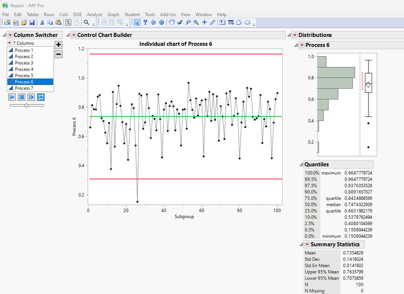

Re: JMP SCRIPT: Control chart based on conditions
Attached is an example of a script that turns limits off and on based upon the existing of external limits
Limits Exist:.....Control Chart
Limits Off:   A Runs Chart

dt = Open( "$SAMPLE_DATA/Process Measurements.jmp" );
// myList = {:Process 1, :Process 2, :Process 3, :Process 4, :Process 5, :Process 6, :Process 7};
myList = dt << get column names( continuous );
// Create the Control Chart
nw = New Window( "Report",
	H List Box(
		columnSwitcher = dt << Column Switcher( :Process 1, myList );
		gb = Control Chart Builder(
			Variables( Y( :Process 1 ) ),
			Chart( Position( 1 ) ),
			show two shewhart charts( 0 ),
			Show Limit Summaries( 0 ),
			Show Control Panel( 0 )
		dis = Distribution(
			Continuous Distribution( Column( :Process 1 ), Process Capability( Use Column Property Specs ) )
columnSwitcher << Link Platform( gb );
columnSwitcher << Link Platform( dis );

	// Check to see if limits exist in the limits table
	If( Col Number( As Column( dtlimits, nextColumn << get name ) ) != 0,
		// Limits Exist, therefore set the limits
		For( i = 1, i <= N Items( cbs ), i++,
			get_cbs;
			cbs[i] << Set( 1, 1 );
		// Limits do not exist, turn off the displaying of limits
			get_cbs;
			cbs[i] << Set( 1, 0 );
	nw << bring window to front;
columnSwitcher << Make Column Switch Handler( Pre, Post );
Jim
