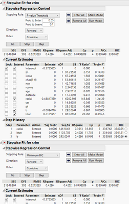

Hi @yuichi_katsumur   Thank you so much for your previous help about JSL stepwise. It worked well, the stepwise only has one P-value threshold, but this example below has two Stepwise method, one is P-value threshold, the other one is Minimum BIC. When I used your code to save the model it has two models, I have to use code to delete last script every time after saving models. Is there any way to remove minimum BIC in the graph below?
The direction for stepwise I used is "Mixed", but the graph below only shows "Forward", so what's actual direction used in the script?
@jthi can you help take a look as well?

I just noticed that the direction is forward only. How can we change it to "mixed" in the code above?

Hi @lazzybug,
I'm sorry, I found an error in my script. Please replace ; with ,.
// Previous script
Prob to Leave( ^var2^ );
Direction ("Mixed");
Rules("Combine");
// Correct one
Prob to Leave( ^var2^ ),
Direction ("Mixed"),
Rules("Combine"),
