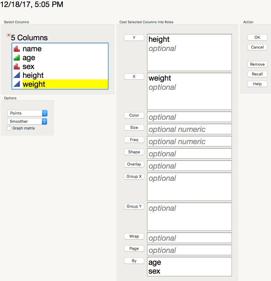

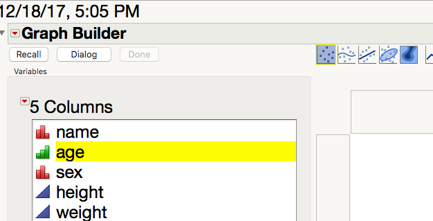

Hi,
If you use the dialog option. And then instead of the page role you can use the by role.
Use Dialog OptionUse Dialog Option
Graph Builder By RoleGraph Builder By Role
Now, if you journal the output and then export the journal to ppt this should give you what you want.
Stan
