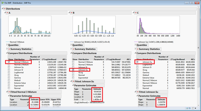

I want to get the data in red below back into JSL. I know how to have JSL create the below, but not to get the fit function(s) the user selected and then the paramters for that function back into JSL, for each distribution. Thanks.

Changed title to see if I can get some help. The data has to be there, but I have not been able to get it. I have tried playing with the "Show Properties" function when creating the display window, but cannot figure out how to pull back what is checked and the the parameter values. If I was creating my own check box list and table I could get them, but not with JMP doing it... Creating it myself is not an option as I need the platform to do the work.
