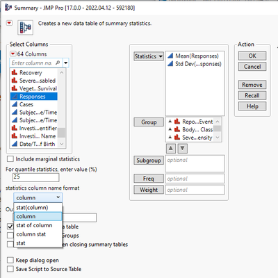

Re: How to rename column of summary table?
you can also rename those stat columns with the drop down in below menu ...
