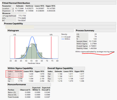

When I ran the data with subgroup ID using JMP, the Cpk calculated is based on I-MR (photo below):
Since R-chart, s-chart or MR are just used as std. dev estimates (using formula R-bar/d2), how can I configure JMP to calculate the capability analysis using R or s when I want to?

You can use the Process Capability platform.  Here is some code that shows how to create a capability analysis where within sigma is estimated by the average of unbiased standard deviations.
dt=Open("$SAMPLE_DATA/Semiconductor Capability.jmp");
Process Capability(
	Process Variables( :NPN1[:wafer] ),
	Within Subgroup Variation( Average of Unbiased Standard Deviations ),
	Individual Detail Reports( 1 ),
	Capability Box Plots( 1 ),
	Goal Plot( 1 ),
	Capability Index Plot( 1 ),
	Process Performance Plot( 0 )
