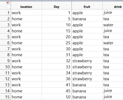

I have a data table (attached) with the following columns and rows:
1. I would like to loop through each column at a time starting from column "fruit" and plot a Logistic plot by "location" and send the output to a journal.

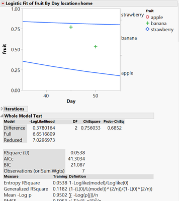

2. I would like to completely remove the summary statistics which come with the plots using JSL.

I get this output (there are more graphs with summary statistics, I just can't fit all of them here):
