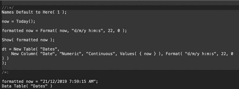

Re: JMP 15 date time format changes
Like @txnelson I was unable to reproduce this problem. Here is my attempt:
This picture shows the Log. The format specified with forward slashes still works.

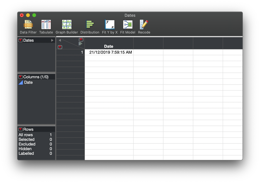

The data table show that the column format specified the same way also works.
