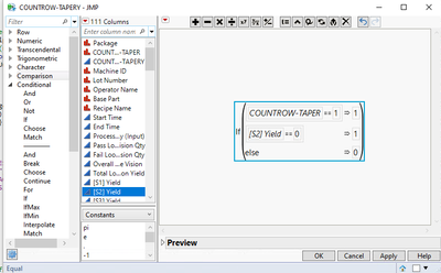

First, we select the Conditional function group and then select the If function.
This creates an IF statement with two THEN clauses.
We know that we will group the data into three bins, so we add a third clause.
To do this, we click the ELSE clause, and click the caret, or insert button, from the keypad twice. This inserts two new arguments into the formula.
Now we populate the formula, one line at a time.
We click the first expression box and select the variable Year from the column list.
Then, from the Comparison function group, we select a < b. We enter 1963 into the box provided. When this condition is met for Year, we want this new column to have the text value “Before.” So, we enter “Before”, including the quotation marks, as the THEN clause.
We repeat these steps for the second line. Year is the expression, the year 1967, and we enter “Transition” as the THEN clause.
In the last row, we need to make only one change. We enter “After” as the ELSE clause.
We click Apply to test the formula. In the data table, you see that the column Vaccine is populated with the values Before, Transition, and After.
We click OK to close the formula.
