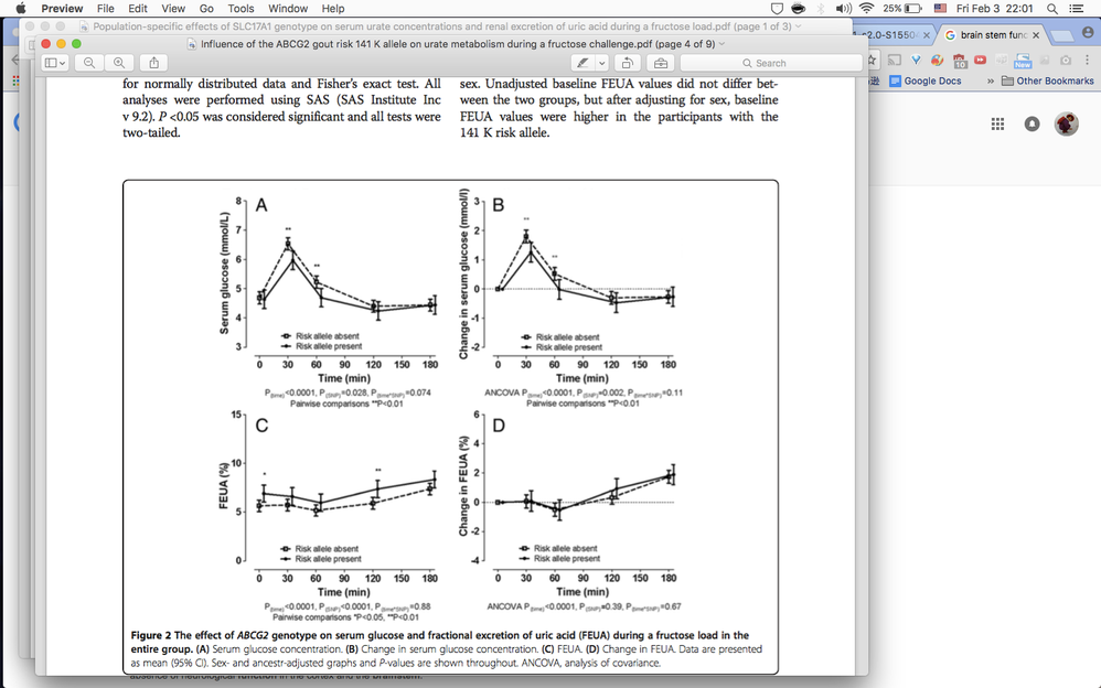

Hi, I'm new to JMP and have been trying to make some graphs similar to the following graphs (see picture) for hours just couldn't get it done. Basically, I conducted gluctose tolerance test on several people, so I have their blood glucose values in 0, 60, 120 and 180 minutes. What I did was to group these people into two groups, obese and non-obese. Now I want to make a graph that has two curves, one curve represents the mean values of blood glucose as trend (with error bars) in three hours in the obese group and the other shows similar results in the non-obese group. Anyone knows how to do it? Your help is greatly appreciated!What I wanted to make.What I wanted to make.

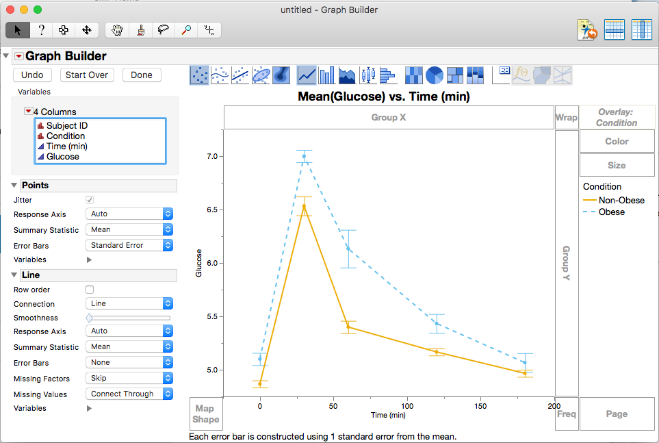

Here is an example of how the table should look:
And then use Graph Builder from the Graph Menu. I dragged and drops the columns to the appropriate axis and condition to the overlay section. I then double clicked on the line on the legend and then selected the Obese line and changed line style to dashed. I also added error bars for the points section and selected summary statistic as Mean.
The options should look something like this:Screen Shot 2017-02-03 at 21.17.06.png
 Does that help? Am I missing any thing?

Re: How to make this kind of graphs in JMP?
Hello,
These types of graphs are possible and it depends on how you have your data structured in the table. Can you give and example of how your data is structured?

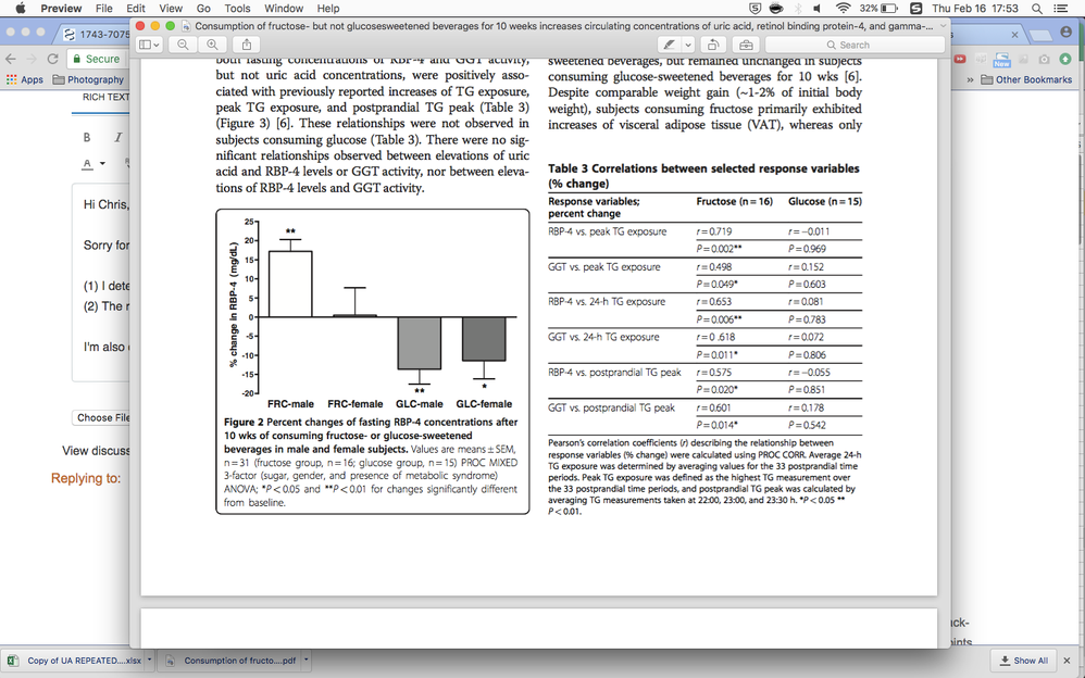

I'm also creating a bar chart but I couldn't make it look like that is presented below, meaning that I couldn't make the bars having a black outline with a white filling like they did for "FCR-male".
txnelson
Right click on the graph and select customize.  You can then change the fill color
Jim
Hi Ruby,
Thanks for getting back to me.
1. Using a manual annotation method I described should work for you.
2. JMP will not be able to calculate the AUC in graph builder. It does do this for Logistic Regression, some curve fits for Non-linear platform, Partition and some other categorical response based modeling methods. For the comparison, if you goal is to say there is a statistical difference, a t-test or analysis of means would be good enough and you could get the mean difference between the groups. But if you are trying to quantitate the amount of difference, then I can see why you would want to use AUC. Maybe summing up the means at across the time points for each of the two groups and then taking the difference would give you an idea of the difference, You can used a combination of Tabulate (time as rows, glucose as a column with condition nested within), then make into data table, and then make a column formula to make the difference of each time point and/or the sum of the columns . Somebody else might have a better idea.
As for the bar chart you are trying to recreate, unfortunately the only way to change the fill color and still have a black boarder may be restricted to scripting it at this point. One can change the colors in to a Black and White scale using the color drop zone in graph builder and then changing each color of the groups one at a time or by using a color scheme. Now if you used an outlier box plot that Jim shows, then his method would work quite well.
