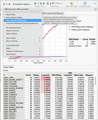

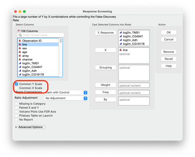

There are two ways to get the Volcano plot and the Mean Differences table to show when using Response Screening from  Analyze>Screening>Response Screening:
  • In the dialog box before running Response Screening, you can check the box Common Y Scale. This assumes that all of the Responses are normalized to the same scale.

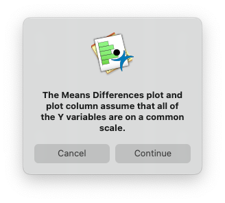

  • Go to the Red Triangle in the Report and choose Show Means Differences
  • You will be prompted in a window that looks like below. Click on Continute
You will now have the Volcano plot as the last tab and the means difference table below.
