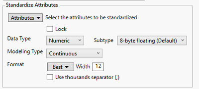

You could try selecting the columns, right clicking and using
