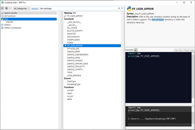

jthi
Re: How to install dt2pandas library in JMP18 python on windows OS?
You can make a copy of dt2pandas.py to same folder where your .jsl file is OR most likely better option, copy it to JMP's site-packages ( Scripting Guide > Python > Creating a Pandas DataFrame from a JMP Data Table).

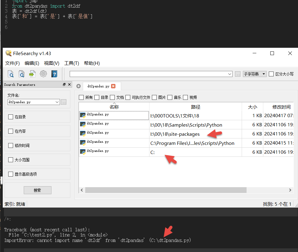

lala
Level IX
I don't know how to operate, I have copied it into two directories
My script is put in C:\test2.py
Thanks!
jthi
The path full path (on windows) is something like this
C:\Users\<user>AppData\Roaming\JMP\JMP\Python\Python311\site-packages (you should be able to access it with %appdata%\JMP\JMP\Python\Python311\site-packages)

lala
Level IX
Neither was successful.

jthi
Have you checked out what you are trying to import? For me that error message is saying that dt2pandas does not have dt2df. Personally, I wouldn't use that method described in dt2pandas.py (at least the version I have) as it messes with your JMP Preferences and that is very rarely a good idea. It is quite easy to write your own function to do this (I assume you are trying to convert JMP datatable to pandas dataframe) and there are quite a few examples in JMP community.
-Jarmo
