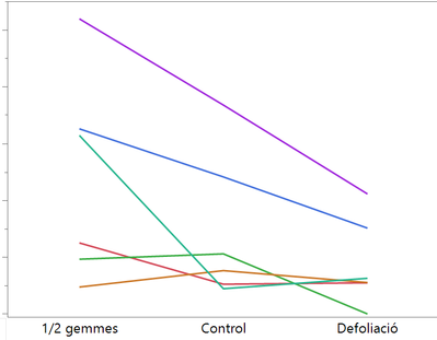

I have a problem that I'm having a little trouble solving, let's see if someone can help me. I am trying to make line graph run in Graph Builder like this:

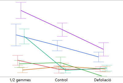

So far so good, a line chart whose statistic is the mean. The problem comes when I try to add the error bars, which causes the points to move out of the corresponding x-axis category. This causes confusion and a bad visualization of the data. Attached is the example:
Is there any way to solve this problem?

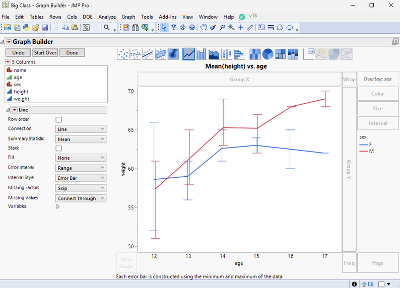

What you are seeing is because the X axis is either nominal or ordinal.  In your example it appears to be a Character column, which is nominal.  If you recode the values to numeric, continuous, and then use the Value Labels column property to map the numeric values back to the 1/2 gemmes, Control, Defoliacio labels, the offsets will be eliminated.
Here is an example using the sample Big Class data table where by default the Age variable is numeric, ordinal.  When plotted in a similar layout as your chart, it has the same issue with the offsets.

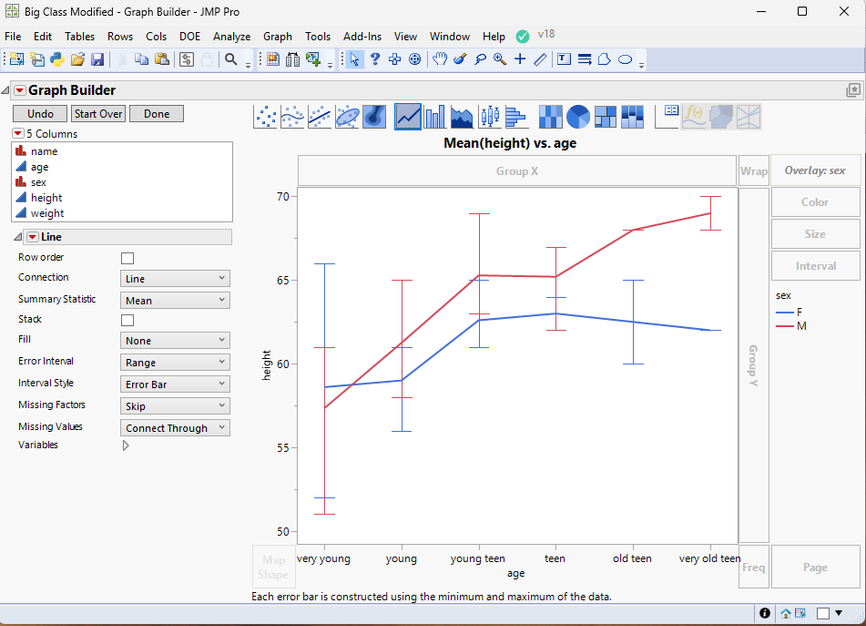

In the below graph, I changed the age column to be continuous, and added Value Labels to convert the numeric values to be displayed as character labels and the offsets are eliminated.

Hi @Kaik : Hmmm, how about this? Go to red triangle next to "Graph Builder" and choose "Error Bar Offset...".

Re: Displacement of error bars on a multi-line chart
Thank you for the solution!!
